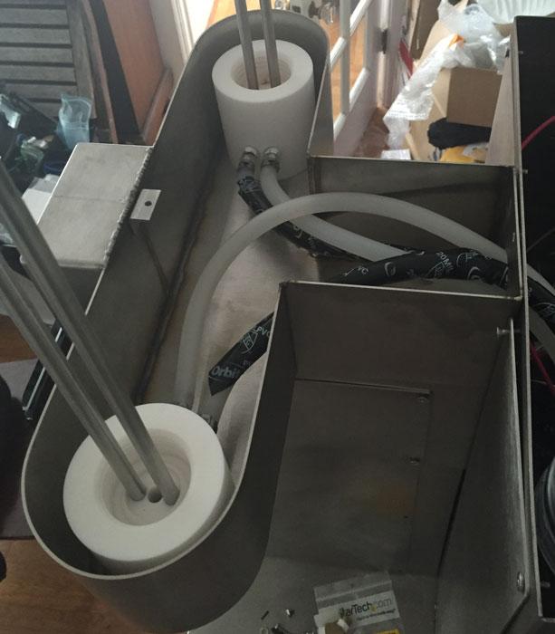

Figure 1c is a photo of the demo machine during assembly. The removable top cover makes assembly and plumbing possible.
Yes, the cabinet shown in Figure 1b was scrapped. The fabricator’s best judgment was not bad; it was not well-informed. This problem extended into required access and mounting for electronics. A well-made but incomplete design resulted in significant rework and make-do.
This demo machine featured self-tapping screws, liberal use of zip ties, and a fair amount of duct tape. In terms of design for manufacturability (DFM), it was not ready for commercial release.

The sheet metal cabinet in Figure 1c may seem to be mostly accidental, but it was a success. Now a crowd of people wanted it to become real.
