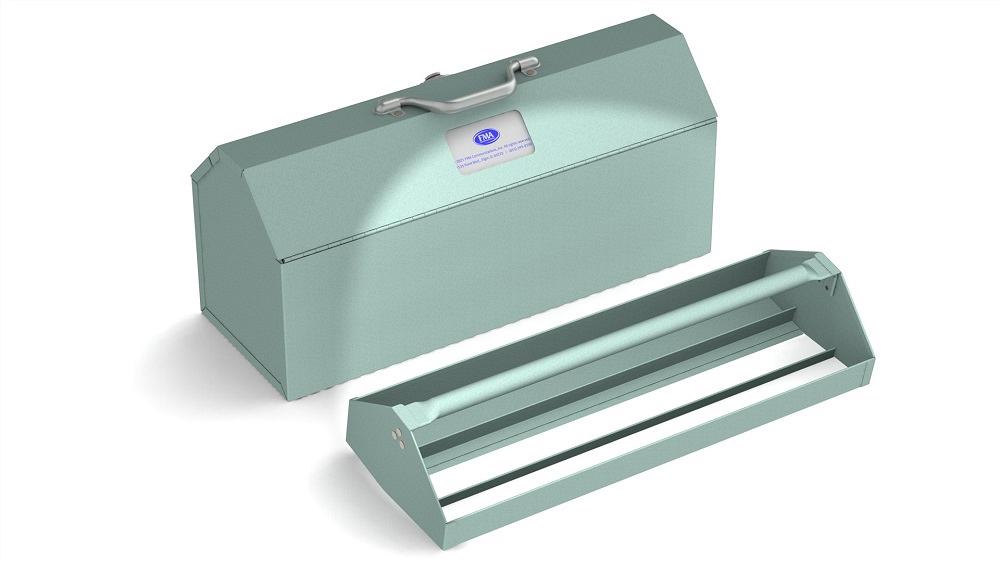

Development of “the product” has moved from the design stage to the documentation stage. Fabrication of the tray, shown in Figure 1A, requires a combination of rivets and spot welds. The CAD task at hand is to prepare the 3D model for use in creating illustrations.
The handled box, along with this removable tray, is part of a larger (imagined) project—the FMA Tote Box. The FMA Tote Box project was introduced in August and as a “cut-length BOM project” in September.
Figure 1B shows the bill of materials (BOM) table for the entire tote box. The red rectangle and yellow highlight point out the tray’s role in the project. The drawing that is to be created for the tray will have a similar BOM table and Exploded View that shows the parts that make up the tray.
